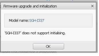

i bought the samsung galaxy s4 new, i rooted it before then i unrooted by uninstalling the root and trying to upgrade the firm from Sasmung Kies it worked the 1st time, then i wanted to upgrade the firmware just to have a new stock ROM and start downloading my apps againe but it shows me this message when i plug it in
i've tried the following to solve the problem but any didn't work:
1-uninstalled Kies and re-installed (made sure the Samsung drivers are uninstalled as well)
2-uninstalled Kies and tried to install the USB DRIVERS from the phone by using the USB DEBUGGING
3-tried different USB ports
4- different computer
5- kies lite and normal mode
non of these worked please i need help this problem.
you can e-mail me if i didn't reply on your reply fast means i didnt recieve the notification because its my first time on this forum
thank you
thank you

i really believe what are you saying and i understand but my issue is not the rooting i did the rooting once and i unrooted before with no problems...my issue is i want to UPGRADE THE FIRMWARE from KIES but its telling me its not supported..

yes i've tried ODIN too to restock it tells me fails every time..and even tho the root i had it wasn't thru the ODIN it was the CFMODE.
What ODIN are you using? I had terrible luck with 3.09. I think it was 3.06 that worked the best and was able to communicate with the phone. 3.09 couldnt for some reason.
And I know it sounds stupid... But have you checked the drivers? I had to update mine manually. Even though I had kies installed.
yes i tried that to i tried everything possible would help but turns no good results..and i really dont remember what ODIN version i've tried i believe it was the really old version which was v1.85 and the latest version which was 3.09..i'm not sure but would you give the link for the v3.06
i tried that too..but i really dont remember which ODIN i used but possible it was v1.85 and the latest which was v3.09...do u mind giving me the link for v3.06?

to make kies recognize your galaxy s4 go to dial pad *#0808#
choose (AP)
under that choose (MTP+ADB)
REBOOT
Then connect to kies
choose (AP)
REBOOT
Works great, thank you.
