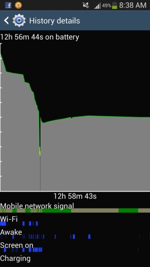

It also happened to me and now I'm experiencing weird battery and as you can see in the graph there is a line between the lowest discharge and it indicates that my battery suddenly reach 0% and when I rebooted the device it sudden reach around 50%+ then I tried using quick start that can be found in *#0228# then my battery suddenly decreased its charge and after awhile it suddenly rose up again even of it is not plugged in. What to do?
