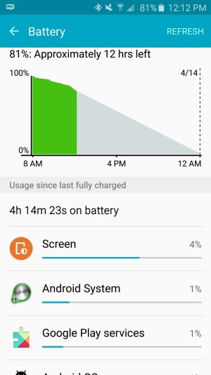

I turned off location services history last night, disabled all google apps I don't use and removed sync from any google app I didn't use. Thanks everyone for the tips. Today is a night/day difference so far:

Sure - go into settings, Personal, Accounts. Go through each account and turn off sync you don't need. Specifically, Google likes to try to sync EVERYTHING. I turned it all off except contacts, music, and chrome.
Next go to the application called "Google Settings" in your app drawer. Scroll down to "Location" and on "Google Location History" turn it OFF. I think that might have been my main culprit.
Hope this helps!!

wow, surprising that is needed more battery than the screen
Hope this helps!!
Thanks, the sync thing helps a ton. I would have never found that on my own.

I've been on the phone regularly today doing stuff and I'm pleased with battery performance
