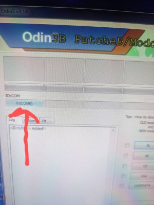

Now don't take offense , com in Odin top left show device connected? You are in download mode pressing volume up to next page?
Sorry but have to ask as im not there with you
Make sure in Odin n option list highlighted are only auto reboot/F reset time ?
No offense taken. Yes i've got the download mode with the volume up to advance to the "download do not disconnect target device" page, on the phone, and Odin listed the phone as "added".
