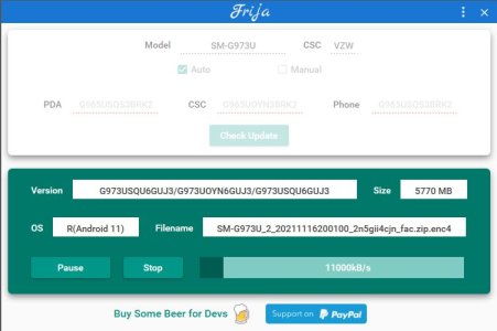

I used Frija just now. Seems the latest Verizon firmware is 2021/11. But it is still older than TMobile firmware of my phone. Can I flash with that 202111 Verizon firmware?Capture.JPG

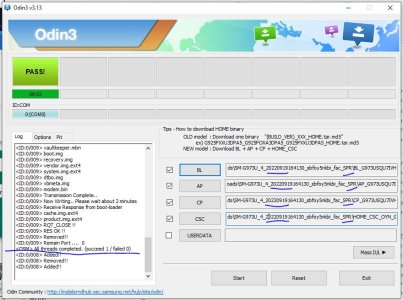

I downloaded a latest version of Spint (SPR) by Frija, same BL version (G973USQU7IVH3) as TMobile, almost same time 202209 as TMobile 202210. Odin could finish flashing with the Spint firmware, sounds lucky. A successful flashing screenshot is attached below. When the phone rebooted after flash, I expected to see the Spint login screen. But I still saw the TMobile pink login screen. Nothing changed! Seems the firmware flash by Odin did not do anything on my phone. It is so weird.Capture_SPR.JPG

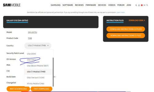

One more try. I downloaded firmware of USC (I do not know that carrier, just gave a try), same BL version (G973USQU7IVH3) as TMobile. Flashing had failures about serial COM port, but completed. Then rebooted, still saw TMobile login screen. Nothing changed, same issue! Odin cannot change anything on my phone with any firmware. So sad. What wrong may be?
