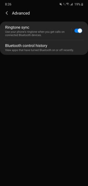

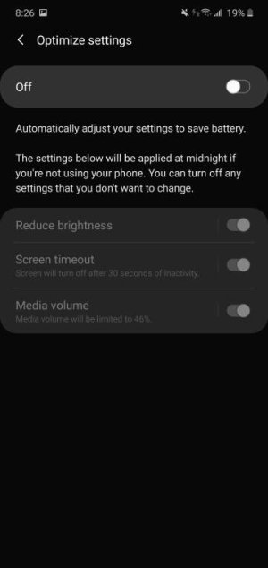

Check some of these
Bluetooth history any apps controlling bluetooth
Device care settings for optimized not on can reduce volume up to 50%
Any extreme power saving modes like medium or adapt
DND ( do not disturb) not on can limit media volume
View attachment 318602View attachment 318603
