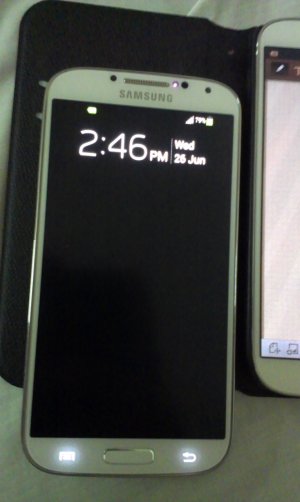

Guys look at my samsung galaxy s4.i put it above casing that have magnet .and it messing with my phone screen.are magnet really dangerous to phone?

Actually, I just spoke to two Samsung Agents (about the Samsung Galaxy S4) and they both said that a magnet on a case would not harm my phone.
I don't know if this is because this used to be an issue perhaps and now its resolved? But when I didn't trust one, I asked another and received the same answer. So I'm convinced my phone is safe in my flip case with the magnet strip holding it shut. Hope this helps clear up any doubts. This post was the first I saw and it scared me and led me to be wary so I hope this saves someone else some time. :)
