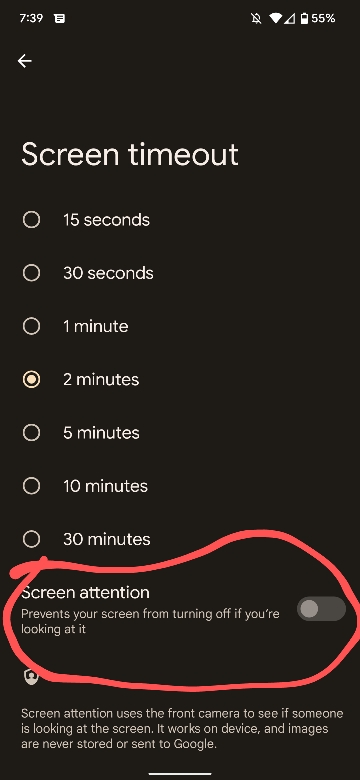

Do you have this turned on if so maybe why? Just a guess.
