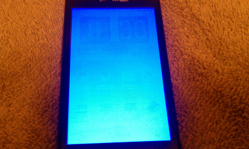

Anyway to get pics to see it? I've never heard of this issue before.
Here is a pic of burn in on AMOLED,,,,

If you look at the picture, the clock is almost entirely stuck at "9:36" - burn in doesn't occur like that unless it locked up for several hours or was done intentionally.
Something smells fishy...
Wow, you're right about that! I didn't notice it until you mentioned it and I went back and took another look at the burn in screen. A screen doesn't burn in like that during a one minute time segment. The clock would have been running and the time changing the burn in there would be blurred with several different digits overlaying themselves.
I can't say that something is fishy but this doesn't add up.

I'd like to see a pic of that please.
