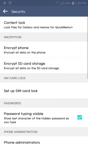

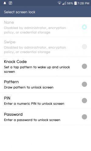

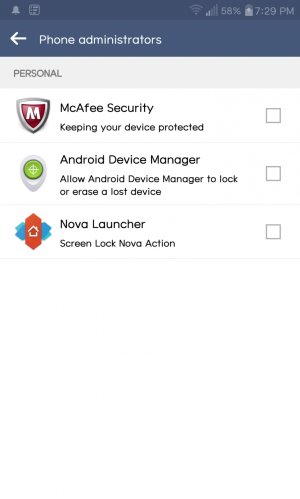

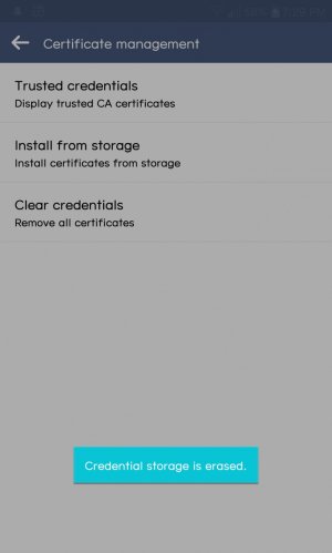

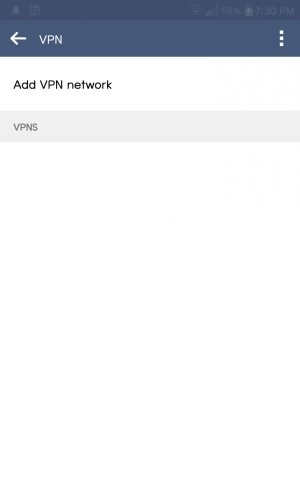

Hello, people. I´m going to be as brief as possible. I want to change my lock screen to Swipe (going from Knock Code), but the options are unavailable. The text says "Disabled by Administrator, encryption policy, or credential storage". I have already tried clearing credentials (however the options to clear them isn´t greyed out), removing Phone Administrators, I don´t have any VPN and neither my phone nor my SD card is encrypted. I entered Guest account and the default option is Swipe, so I don´t think there is a problem with my phone, but rather with my setting. Any help? I´m using Android 6.0, no root.
("None" is selected because I, on purpose, failed to enter the right pattern, selected "Forgot pattern", used my PIN and didn´t choose a new option).
(Both encryption menus are unaltered).

I unselected every single certificate under System, but it still didn´t work. I booted into Safe Mode, and didn´t work either. I´m getting mad at this.

Dear group,
I was having the same problems as the original poster and I have come across this page when searching for information on the issue.
I tried removing device administrators but that never worked.
My phone is not encrypted.
I then went through my certificates and saw that I had loads. I could not bear to delete them one by one in order to find the culprit.
I chose the option 'clear credentials' and it has eliminated the problem.
I just hope that I never cleared an important credential because I have no idea what they do.
Thanks for this thread!
