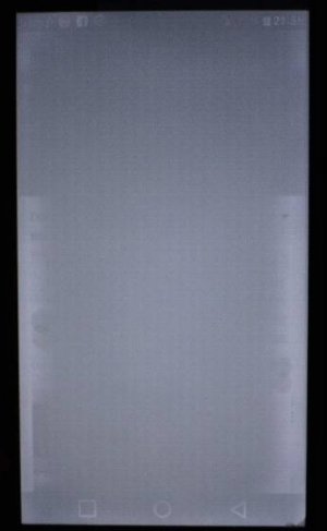

Screen retention arghhhh!!
I made a thread on Reddit asking if anyone else has this problem. From the responses, it's about 50/50. Some have if, some don't. For those that do, it gets worse. I'm not sure how much worse, though. It's tolerable, but I'm worried it might degrade more and more over time.

Yeah this is my first LG phone coming from the Note 7 and I have had issues with this phone and the latest issue is this screen retention it gets annoying after a while, I might have to call and see about warranty replacement.
I was shocked how many of V20 users in my country having this very disappointing issue..
So we have an issue that's more prevalent in certain countries....could be a voltage issue.
So if it's a voltage issue what should we do? Cos I had to replace the screen after 6mos of use. Good thing it's still covered by warranty cos screen costs 150usd.
