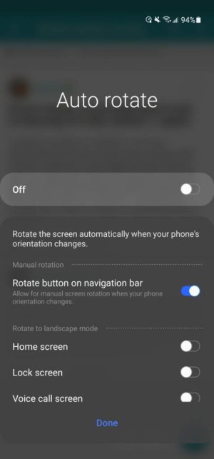

Can try this , pull down your notification panel and long press the portrait toggle and see if these are onScreenshot_20210130-102316.jpg

Auto-rotate doesn't solve it at all. The only way is to restart the phone which is absurd. And after a while the auto-rotate stops working again...
