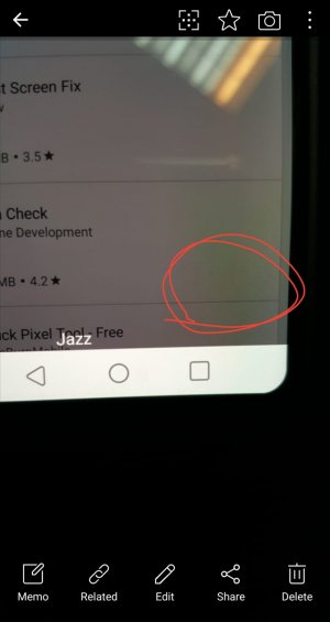

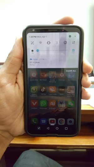

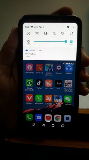

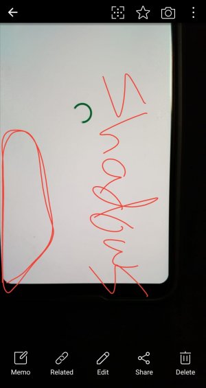

I have the same screen issues with my lg v30 plus....any solution plzzz
1. Screen shows shadows of images on low brightness not on high brightness
2. Screen burn images of Pubg mobile games showings Guns shadows and some others game stuff
I m here attaching some images

I commented on your original post asking about this, but something needs clarification on this thread. The V20 has an LCD screen, which can get temporary image retention for some reason. The ghost images will go away in time as long as the screen has a chance to rest.
The V30 changed to an OLED display. The ghosting you're seeing is permanent burn in due to the nature of the technology. Each pixel emits its own light (no need for a backlight, like on LCD's) and wears out over time, resulting in a dimmer display. Static images cause the pixels to wear out at an uneven rate, resulting in those shadow areas. As was said in your own thread about this, your only option is a screen replacement.
Re: Screen shadows and burn in display
OH my GOD......I have no option for replacement, it will cost me the price of a brand new lg v30
