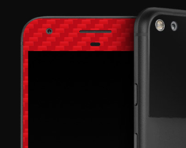

Maybe the OP does not have a screen protector, but how about a skin similar to this DBrand skin, but a cheap one without the proper cutouts?
