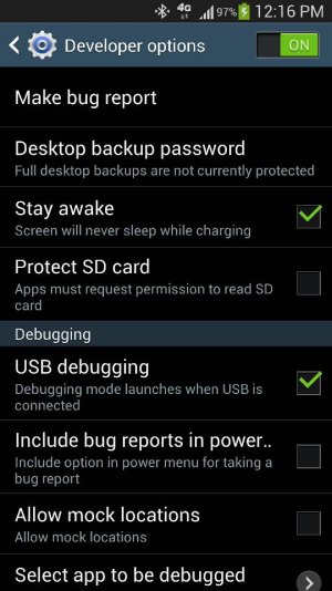

Mine also stays on, but I have the stay awake option checked.
