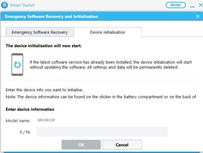

just done exactly every step in the tutorial you have linked me too and it's not working, the problem with the tutorial is i should see SmartSwitch (2).JPG and SmartSwitch.JPG but i do not get this options at all
What about Odin? I'm never quite sure how well Smart Switch works for this kind of thing.
I have Odin downloaded and i have used it and downloaded the original firmware files for my model of my phone and serial i flashed it via odin to original firmware i downloaded from samsmobile it took a little while to flash the phone and once rebooted exact same error came up again and still cannot use the phone although after flashing with odin it stated the process passed and was successful but meanwhile still have same problem
