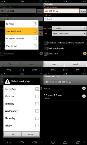

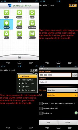

It's pretty simple, I slapped together a quick guide for you.
Thanks for the guide but it apears that you are adding numbers to the blacklist for a specific period of time. I do not want a blacklist for a specific time I want everyone to be on the blacklist for a specific time period with the exception of people on my whitelist. I don't see where you are using the Google Calendar (which is actually better as far as I am concerned).

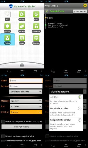

Here's a quick guide to setting it up with Google Calendar.
It's the last guide I'll be making for this thread (LoL), sorry.
