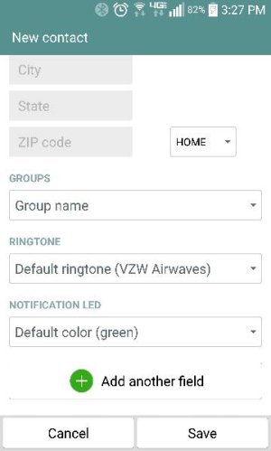

Hello all, I am trying to figure out how to get my gf's G3 setup to allow separate notification sounds for different people. Is there a secret menu or a separate app needed?
Select one your girlfriend contacts. Select the pencil at the top to 'edit'. One of the fields in the contact says 'Ringtone', with a drop down menu to select a different ringtone.

Last time I checked with the newest firmware update i do not recall seeing that option under the Edit. I will check again tonight thanks.
So the only choice in there is for a ringtone not for text messages. Is there another way to do this other than using a texting app?

You should be able to set your messages notification for each of your contacts in the default contacts app (using the pencil/edit icon.).It's right below the runtime setting for the contact. Lg g3, at&t, stock contacts and messaging.
