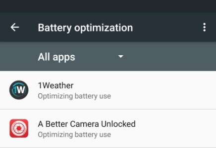

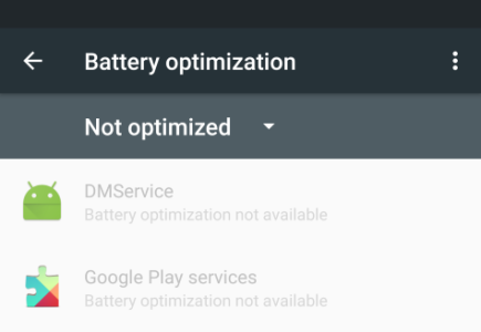

Back to that window. There are two parts... "Not Optimized" and "All Apps". The two apps listed in 'Not Optimized' are critical system processes that are permanently excluded from either Doze or App Standby.
All the other apps are listed under "All Apps", with their setting included in the window
Now, you can go in and start excluding processes from optimization, but that will quickly defeat the purpose. The more apps you exclude, the less effective Doze will be.
