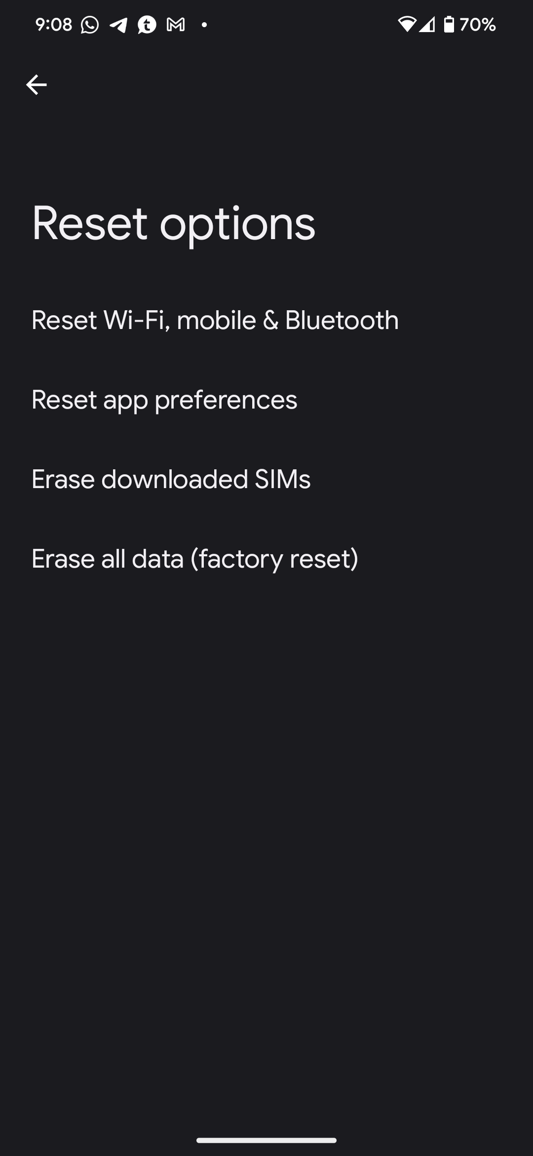

Have you tried resetting network?
Can you describe exactly what you mean by that.
At the moment of signal drop, manual network search is not possible: it finds no networks. After reset, there is no problem with manual network search. More than 6 networks are found then.
Sent from my Pixel 7 using Tapatalk
If you go to settings>system>network reset this reset mobile network but also wifi passwords and connected Bluetooth devices
Sent from my Pixel 7 Pro using Tapatalk
I'll do that next time when problem appears, but I doubt that this is actual solution to my problem.

Ok give it a go but it is one of the troubleshooting steps that must be tried to eliminate it .

Thnx for advice. I just did that. I'll report back if it helps.

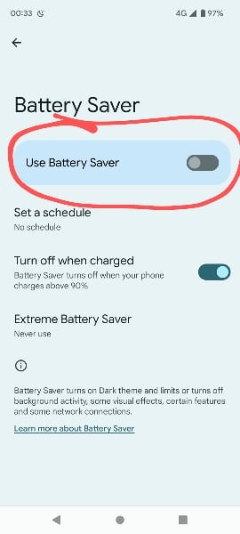

Hey all of you who tried to help me out. I've been searching for solution to my problem and I noticed someone replying to users with same problem on youtube, to turn off power saver mode. After a week of absolutely no problems I can say, that this solved my problem. Since you're actively helping other users, please spread the word. Have a great week.

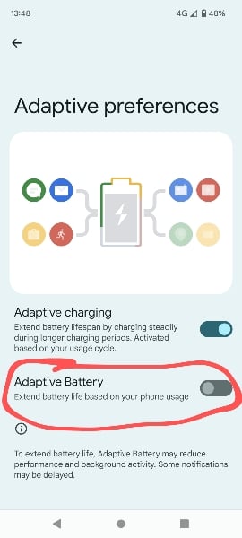

It was late last night when I posted about solution to my problem. Here is setting that was causing signal loss when starting a call. After turning Adaptive Battery off it never happened again.
