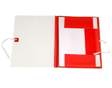

If someone put a nano card without a tray, this is what you need to do:
1. Find a sheet of transparent, thick plastic, it is widely used as covers for documents etc. It looks like this
teczka_wiazana_pcv_kolor_biurfol''.jpg Make sure it's hard, not soft, soft won't help you. There are two kinds of that plastic and you must get hard one.
2. Cut two strips, they must be as wide as a nano card and 5-6 cm long (so you can grab them)
3. Carefully place two strips under and over a stuck card, make sure you don't pry too hard to not to break something inside the slot
4. Try to remove the card with strips of plastic, I succeeded after first try. It's because a card with two plastic strips under and over is thicker so you can take it out.
5. Be very careful because it's my own, homemade idea, I was desperate but it helped. I felt like a ******* genius after that so I decided to share it with other (accidental or not) blockheads. So, people, read the guidelines. I just learned that. If you have problems with understanding my instructions, ask me.
I hope it helps.
Thanks a ton Rusofil!
Same thin happened with my Samsung Galaxy Note 5..and I used ur technique of plastic strips and it worked like magic ;D
Aldough I used just one strip which I inserted deep enough and then pulled at right angle...
Thanks again :D
Similar thing happened to me - stuck my micro sim into my new Pixel. Self inflicted wound.
I tried to use rusofil's solution above. Even came up with a better thin plastic material. You can use the plastic file folder tabs for hanging files, and cut to fit. Unfortunately, on the pixel the edge of the micro sim got behind a lip on the front edge of the phone, so I could not get the plastic behind there. kusumitha's method of just using one plastic didn't work, because it just pulled the sim card tighter behind the lip when pulled at 90 degrees.
So, the winning system was using a couple safety pins bent open, and VERY patiently working it out of the slot. It took about 20 minutes. I didn't use both safety pins at once. One was larger, and one was smaller.
Ok - off to get a nano sim.
