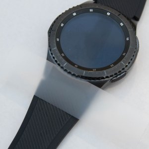

I got annoyed by the metal clicking sound when you touch the bezel on the Gear S3 Frontier. The reason for the clicking sound is the slight spacing between the bezel and the watch itself. I guess this spacing is necessary to ensure the bezel can be turned easily. It seems to be different between individual copies of the watch.
All you need for the fix is some scotch tape and an Xacto knife.
First take about 2 inches of tape and with the sticky side facing down push it between the bezel and the watch (see photo).

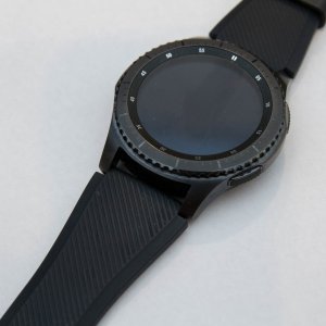

Then use the Xacto knife to cut off any excess tape along the bezel. The closer you can cut to the bezel the less visible the tape will be. See the result on the following photo. It is barely visible.
I did it on the top and bottom of the watch and I have no more clicking. The rotation of the bezel is still fluid.
