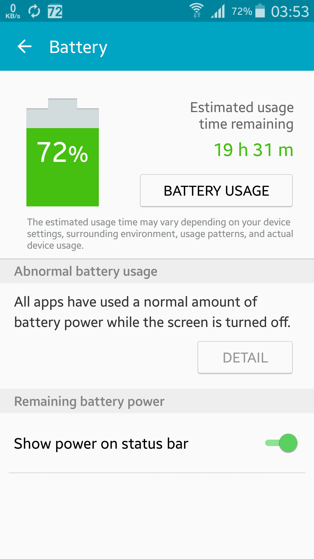

No, actually I didn't, and I just looked for it, I don't seem to even have this option for app optimization, where could I turn it off!?
edit: It says "all apps have used a normal amount of battery power while the screen is turned off" the details button is greyed out, Smart manager seems to be not able to grasp my working apps I guess.

Go to...
Smart Manager > Battery > App optimisation > Detail
See my edit post, the Detail button is greyed out on my device, Smart Manager seems to not be grasping my apps battery usage stats.What can I do?
Go to...
Settings > Application manager > All > Smart Manager Provider... and clear cache and data, (in Manage Storage). Then go back to the Smart Manager app and disable Optimisation.
Still it looks like this
Same as mine. Just touch the Detail button and disable Optimisation, as per post #8.
As I mentioned the DETAIL button is greyed out(see screenshot) and that makes that it doesn't work. --> post #6, #9 #11
Data and Cache deleted, still no difference.
