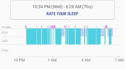

Regarding the "awake" state, my watch seems to detect me as being awake very intermittently throughout the night. Now I'm a light sleeper, as you can tell from the attached image from last night, but I'm pretty sure I'm not awake at all the times indicated. Back when I used the Gear S3, it detected me as "motionless" for the bulk of the night. Is this how everyone else's sleep is looking in terms of the awake state?
After turning on continuous heart rate monitor, I've received more detailed sleep information. Funny thing is I haven't had any deep sleep recorded. Just awake, light and REM. Don't know what qualifies as deep sleep, but my watch doesn't think I get any.
That is my issue as well. I leave heart monitor always on and while it tracks it records zero deep sleep. Coming from a Fitbit Ionic which was super accurate in sleep and heart rate (but sucked in too many other areas) its disappointing and I hope it's fixed. Especially since I only get about a day and a half battery life with HR always on. The Ionic got a minimum of three days even with battery sucking watch face.
