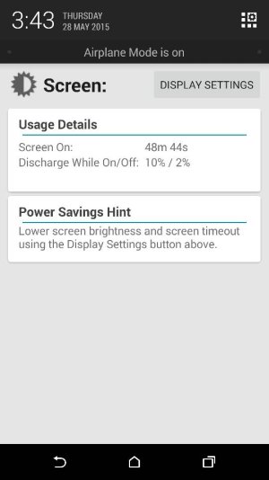

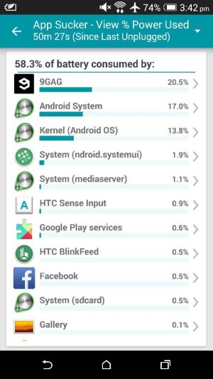

Here's shown under gsam
Wow, is 9 Gag doing something in the background? I've never used it, but that just seems high to me.
Dude you have something eating more battery than android system. That's obviously the culprit.
