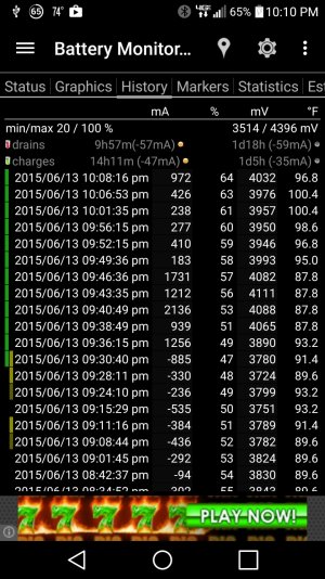

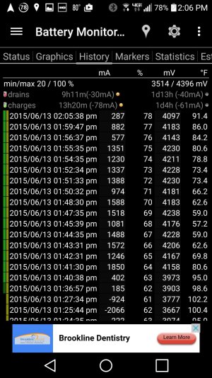

I did a quick test last night, comparing charge current with my case installed, and then I removed the case, and the phone's back, and had a fan blowing across it. I observed higher charge currents as the temperature decreased.
So today I repeated my test. This time using an air conditioner, instead of just a fan, to get the battery cooler.
Ambient temp before starting is 80F. Brightness up fully, Auto-brightness disabled, screen on constantly, WiFi on, Waze running, to try and increase the current draw as much as possible. I used the stock LG charger (1.8A) and cable. I did not unplug the charger, or turn the screen off, during the test. My phone is a Verizon model.
Charge current is *definitely* related to temperature. Presumably the phone's measured battery temperature.
I had the phone sitting around, with the Spigen Slim case installed. It was charging around my usual 280mA. The battery was around 98F.
Then I removed the case, and the phone's back. Turned the window air conditioner on high, and held the phone in front of the A/C's output, to cool it down.

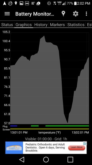

As the battery temperature dropped (eventually reaching 57F), the charge current increased. At 86F, charge current was 600mA. At 74F, current was 1570mA. It stayed around 1500mA even as the temperature dropped further.
It appears that 90F may be the temperature cutoff for dropping to 280mA, since the current changed as it passed that temperature. I don't know when exactly it lets the phone increase to roughly 1500mA.
Then I put the cover & case back on, and turned off the A/C. As the battery temperature increased again, the current dropped off again.
I wish the History tab of Battery Monitor Widget was working better for me. It sometimes doesn't record. I don't have a good chart that shows current, battery %, and temperature all together.

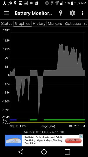

See attached screenshots. In the graph views, the test started with the solid-green line that indicates AC charging. Starting with no cooling, about halfway across the graph, then I turned on the A/C when you see the current spike up, and the battery temperature drop.
So if the phone stays cooler, it will charge faster. Alternately, if the software perhaps allowed a higher battery temperature before reducing the charge current, it would also charge faster.

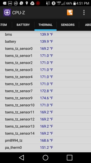

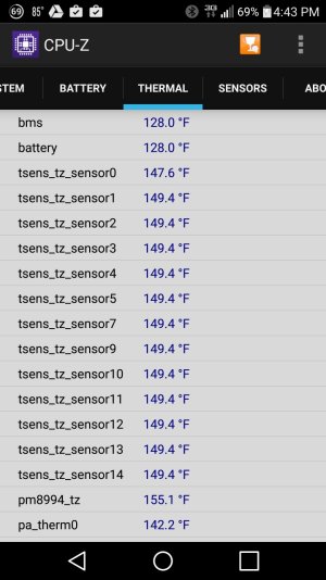

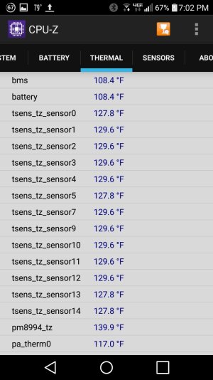

Three CPU-Z screenshots are attached. I don't remember what the phone was doing during the first two. And I have no context for what these temps should be, or what's "normal". But in the first, the #s are higher than I would have expected, I suppose, though that means nothing. In the second, they are even higher, and an app is giving a high-battery-temp alert.

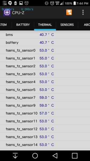

The third was taken during my first charging-current test yesterday, when I had the back off the phone, and had a fan blowing air across it. So it's probably about as low as my temps get. I did not get any CPU-Z screenshots during the air-conditioner test today. BTW, the "battery" temperature entry is not the same value as other apps show for the battery temperature. I don't know what this is actually measuring, but my battery is not at 140F.

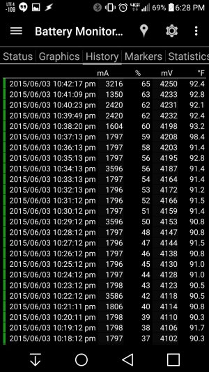

The fourth screenshot is when the phone was charging a few minutes ago, with the screen off, and having just been rebooted. Again using the LG charger & cable. When the battery is still at 88F, the current ranges from 1200 to 2100mA. In the next entry, 3 minutes later, the battery is at 95F, and the current dropped to 180mA.

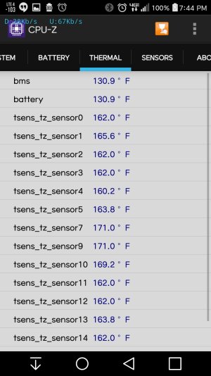

Cpu z has something fishy with regards to the celsius to Fahrenheit conversion. Fwiw, BWM reports 99F
For example 40.7 C~105 F. CpuZ reports 130.9f

Hmmm, very odd :) Your Celsius screenshot of CPU-Z shows 53C, then the F version shows 162F. Except that 53C is 127.4F, not 162F. So there is a conversion error going on.
Interestingly, for me, the Battery tab in CPU-Z shows the correct temperature.
I see the apparent C->F conversion problem on my S3 as well as my G4. I've only noticed it in the Thermal tab. Thank you for pointing that out, I hadn't tried switching between units before to compare. I emailed the CPU-Z developer to let him know.

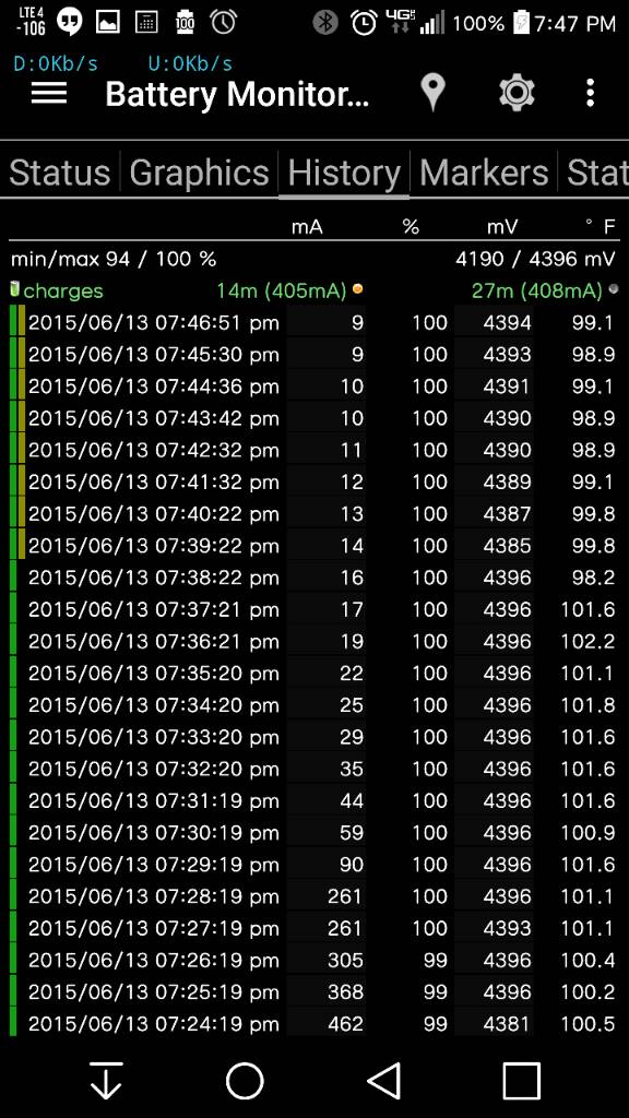

I had my phone on the LG charger overnight, screen off, WiFi off. This morning the battery was showing 102F, and the phone was warm near the camera, when I went to unplug it. Something is generating a fair bit of heat just sitting there, after the charge is complete. The house was at 73F this morning.
I rebooted the phone after unplugging it, to start fresh. In the car (set to 72F, and it's rainy here today, so no bright-sun issues), the battery showed 94F after about 40 minutes of navigation & playing audio, with the screen on, set to Auto, 6%. I was not charging it in the car. So just sitting around, full, on the charger, it was running warmer than when not charging but actually doing stuff.
