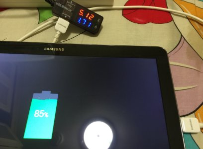

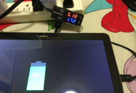

Use this one to monitor your charging current, it should read 1.7 Amps

Here is USB 3 cable and micro USB cable charging current , there is no differences

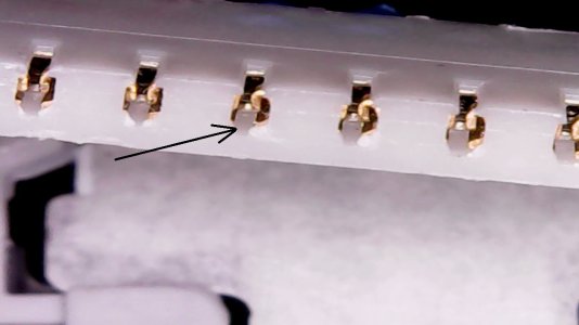

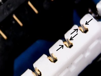

I had one battery that being discarded as dead battery by someone else. I fixed it by pushing all end tips closer to make good contact, then it works like new without any problem . Some people claim to fix the flickering screen by new battery but they don't know their old batteries can be fixed easily. Samsung fix this loose connection by silver conductive glue, I fix by pushing the opening closer
