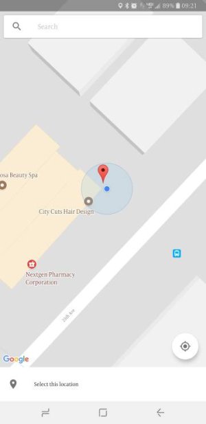

after deleting your existing address, open maps and zoom in on your house, adjust the center of location to be right over your house. See picture, I just tried to add a new location where I'm right now - move the circle to be dead center over your home
