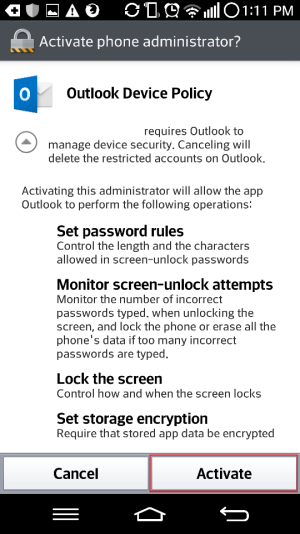

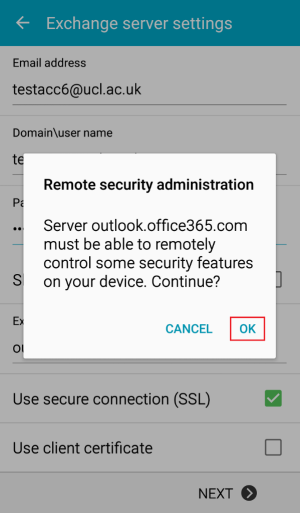

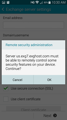

If it stopped after you added an exchange account, the problem may be the Exchange administrative rules.
Exchange servers can be set with specific security policies in place, to prevent unauthorized access.
If they have a policy setup that requires a password / pin to unlock, then the Trusted Places would violate that policy.
When you setup your exchange account, do you remember seeing a "Device Administrator" request screen?
