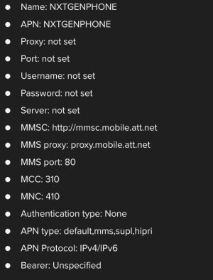

Correct, and Att has been notorious the past couple years for having nothing but issues with their SMS/MMS. I changed the APN to the old NXTGEN APN & it seems to be better.

So just looked up official ATT APN server settings and then added it to my settings. For some reason it was different than the one the phone came with. Then it started working. I suggest you try that too.

This is the NXTGEN APN I use on my phones. I get better and stronger signal with it.

Just do what I recommended in my last post, and the settings posted by the user above. Or you can just Google ATT APN settings. I had the exact same problem with same carrier. Now it works like a charm. My guess is it was a problem with 5g, but you confirmed it. And we can't turn off 5g either on ATT for some stupid reason, so this was only solution that worked for me.
