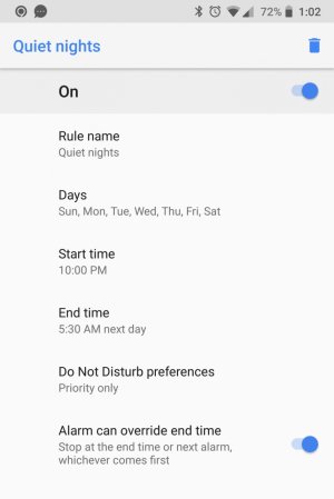

FWIW, you don't need Sound Profile to do that any longer. Go to Settings -> Sound -> Do Not Disturb Preferences and +Add more. My "Quiet Nights" rule looks like this:
With "Priority Only", only people in my contacts that I have "Starred" (at top right of contact info page) can break through the Do Not Disturb when active.

To be fair, these Do Not Disturb functions are relatively new and easily missed if you are not the type of user who really tears into a new phone/OS to learn all the neat, new, stuff that's in it.
