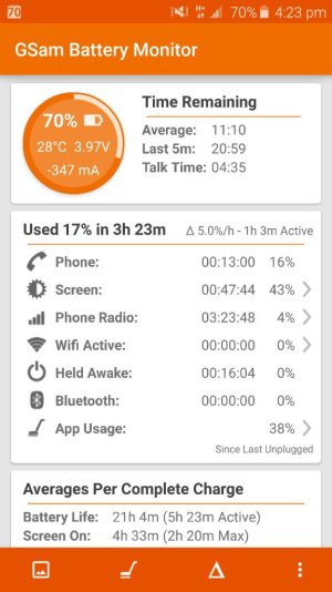

I uninstalled Android Central, AVG and outlook as those were three of the apps that didnt show up on my phone in safety mode. I took my phone off the charger this morning at 87% and this has been the result so far. Its like I've got a different phone. I'll be keeping an eye on it over the next week or so
Avg? ? Don't do that to your a6. Why would you need it for?
My bet is weather daemon and or just plain crappy signal strength where you are. Nothing burns through a battery like constantly trying to search for a weak cell/data signal. It's just brutal on a phone's battery.
