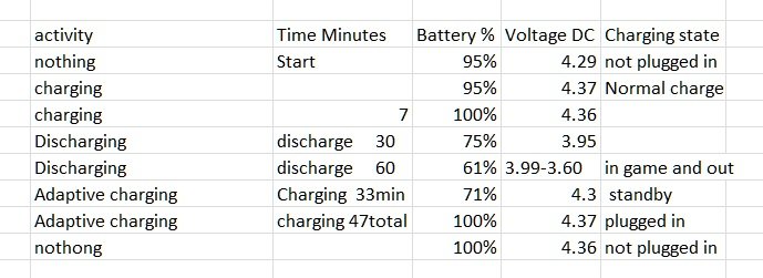

Ok so here is the BEEF! I attached a couple electrodes to the battery terminals of my Note 4. They are the tiny aluminum foil strips that sneak under the battery and out around the wireless charging pad. I measured the voltage and they are as follows:
