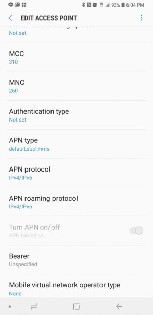

If you are having problem with data in a single game or app then its not a phone problem.
This is default. In this mode the game does not connect to server.
I think perhaps you are missing a key point. T-Mobile is today an IP V6 network. The fact that you can't connect on IP V6 to your game is not Samsung's fault and it is not T-Mobile's fault. IP V4 addresses are/have run out and thus the move to V6. Your game server has likely disabled V6 support. It is their fault.
Regardless, there is a setting that you can try. I don't know if it is still supported. Under APN, put this in:
IPv4/IPv6
See if that works.
Is this how you're recommending I try it?
IPv4/IPv6
See if that works.
This totally works! Thank you!
