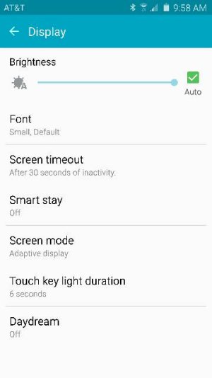

Can't get the soft keys to light up, regardless of the setting being turned on. Any ideas?

My display options on my S6 do not even show the "Touch Key Light Duration" option. what is that for? can you advise what software version you are on?
do you have power saving mode on? if you do, that automatically turns them off regardless of the setting being on or off
I figured it out. I tried out the ultra power saving mode, but when I turned it off I didn't let it finish. I just turned it on again, the back off but let it finish its process and everything worked again.
This was extremely helpful. My soft keys were not lighting after I went into power saver mode. I turned power save mode off, reset the phone and they still were not working. Also, I could not turn on vibration feedback (it was greyed out). I turned on ultra power saver mode, let it load, then shut it off and everything was working again!
