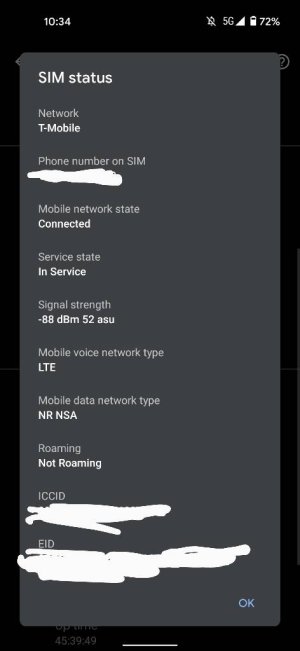

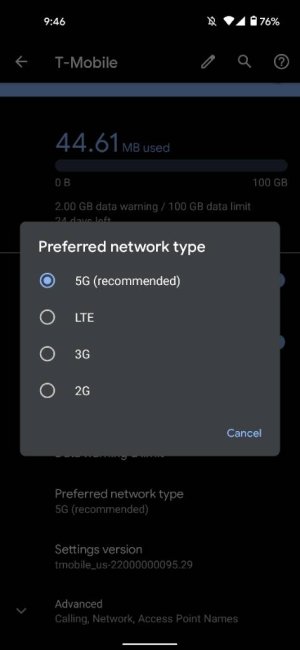

That shows you are on NSA mode(your network shows NR NSA), not stand alone mode. You miss-understood what SA means. It doesn't mean whether or not you can choose 5G from your handset. It means the SA network is a brand new network designed specifically for 5G so it can have lower latency and higher speed. NSA 5G means you are still using a 4G network with 5G radio pegged on it and it typically will share the same latency and speed as 4G LTE.
That shows you are on NSA mode(your network shows NR NSA), not stand alone mode. You miss-understood what SA means. It doesn't mean whether or not you can choose 5G from your handset. It means the SA network is a brand new network designed specifically for 5G. NSA 5G means you are still using a 4G network with 5G radio pegged on it.
So your saying as it stands right now on my T-Mobile with the pixel 5 it's not stand alone ?
