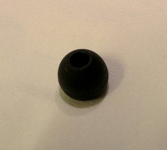

I had home an in-ear headphones rubber spare part like this:

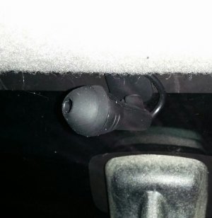

I removed the inner part of it with scissors and then put the "rubber cap" I obtained on Yaris' Parrot microphone like this:
and it works: no echo problems anymore, and since the volume is still high enough, the person on the call can hear me correctly.
