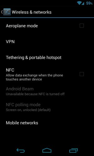

for cell broadcasts:
settings>under wireless & networks: more... > cell broadcasts > turn everything off
