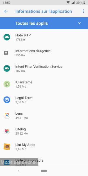

Hello everyone,
first of all, thanks for the tips and help in this thread, and sorry to unearth a Solved case.
I just got a new Nokia 7 plus, made the update to android 9 and installed all my previous apps with which I never had any issues, plus some new to replace old apps that were not maintained (utilitarian, like a kitchen timer).
And now I have the same issues as described here, either popup ads or fullscreen ads appearing while doing my everyday things on the phone.
Following the advices found here I managed to have a glimpse of the offending app in the app switcher, however it disapears before I have the time to click the icon.
I tried looking for apps with similar icon but it took the System UI icon so that's a deadend for now.
I tried using malewarebyte (the scan find nothing) and addons detector to check the apps with permissions to overlap things and uninstalled each one by one, but the ads keep coming.
So my best bet would be to be able to identify the app with the app switcher, but with the app disapearing too fast I don't know what to do.
So I'm now here, hoping any of you have any suggestion for me.
Thanks in advance for the help.
If you think I need to create a new thread, please tell me and I'll do it.

Welcome to the forums. Some apps make things more difficult and you'll need some extra steps to find the culprit. See this guide.
https://forums.androidcentral.com/showthread.php?t=901497
Also, that IU System app looks a bit strange. Select it, scroll all the way down the screen and see what you get under 'app details'. If it says 'installed from the Play Store' tap that option to get more details.
Hello Javier P,
I followed you link and the advices on it, and after a while I am fairly certain I have identified the culprit since it's been 4 or 5 days I haven't seen any ads.
So the culprit was Zingbox, an manga reader app I have been using for many years without any issues of the kind -_-
By the way after looking on the web for it, IU Système seems legit.
Thank you again for your help :)
