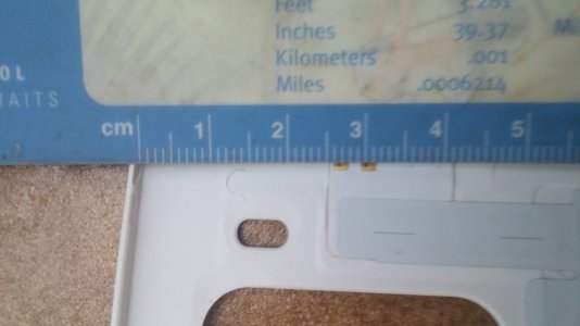

Good idea. I bought a new cover with the Qi coil for my Verizon G3. It didn't work. Measured the distance to the pin marks on my old cover from the sides and from the top, 1228171020d.jpg1228171020b.jpg pealed off the new coil positioned it at these exact distances and it worked. Believe it is a positioning problem of the contacts. Sucks that Verizon again removed a great feature from a phone for no reason requiring a fix to make it work.
