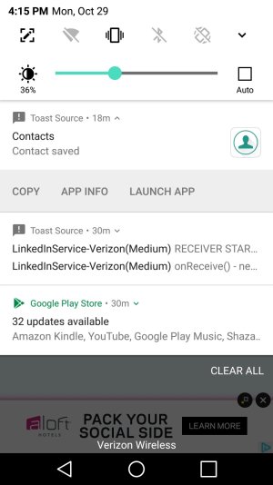

I can get a notification from pretty much any app, depending on what I'm doing. Here's a screenshot of the most recent 3 notifications:

The toaster app will notify me any time I make a change in an app (like the one in the picture from my Contacts app) but the only app that pushes that "RECEIVER STARTED" message is the LinkedInService app.
What you say about the Contacts app is the normal way that app works, it will notify you of any toast message (error or not). It's an app to be used only when troubleshooting this kind of issues.
It seems that the "Receiver" error could be related to the LinkedIn app or any background process related to it. Can you disable temporarily the LinkedIn app and see if the problem persists?

I don't think I even have the LinkedIn app, I definitely didn't download it and I don't see it anywhere on my home screen. I visited the play store and it asked me if I wanted to install it, so I don't think I have it.

That's very strange. It could be part of Verizon bloatware. Can you find it in settings - apps - menu - show system?

Aha! I found the app in question, although it was different than the actual commercial LinkedIn app. I uninstalled, as I assume was the correct move, it didn't seem like it was doing anything important on my phone. Hopefully the bug will go away now.
