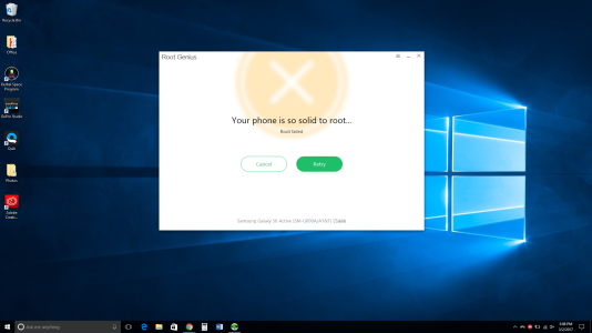

If it dosent work try root genius

power root has been the quickest to give up since i've been trying to root my phone. It broke rootgenius' about 2 minute record by giving up in about 10 secs....

this failed too... it said root failed after about 10 secs... i tried the pc version, and my phone kept reconnecting over and over, and making windows to kept repeating that stupid sound it makes when u plug something in.... so i give up. forget cubot. next time i'm shopping for phone, i'll get something which isn't so unpopular; maybe a sony phone....the reason i didn't get one the popular phones is i hate having something new which, just about everyone around you just got, or is about to...

I have a s6 active but it still says it it "to solid to root". Plz help!! :'(
