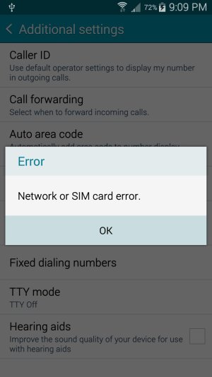

I have the samsung galaxy s6 on att and i have the same issue.. cant access forwarding call info in settings.. network or sim error.. cant get google voice or youmail to work.

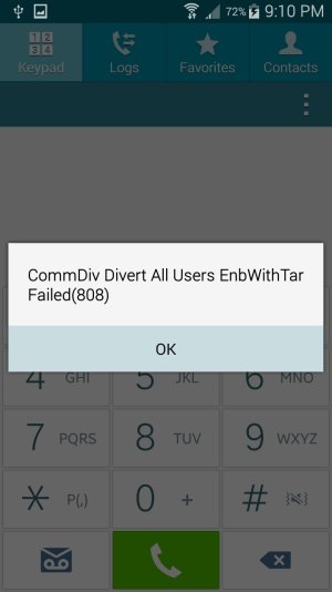

One of the workarounds mentioned (here and elsewhere) was to turn on Call Forwarding. Unfortunately, this is where I get the SIM card network error message. I also get error messages when trying to activate the GV number. I.e., when trying to send *004*15555555# through my keypad (where 555555 is in place of my GV phone number). Following the number given to deactivate likewise didn't work, and resulted in the same error.

There was another solution (to the GV problem), which was to set the phone to have a delay in answering (in order to give GV enough time to answer, instead of the built-in vm). Alas, I still got the MMI error, so it didn't work for me.

PS I also tried using codes mentioned in this thread, I think?, to give a delay in the phone automatically answering. However, I got the same [dang]MMI error code.

for everyone having problems with network error and call forwarding, reset your apn setting under mobile networks. That worked for me

I have all of the same issues described in this thread. When the phone updated to Android 6.0.1, the situation got WORSE. I now get error messages any time I try to even LOOK AT the call forwarding settings. I am guessing this is an Android issue, aggravated by the phone's GSM settings being tied to AT&T, and nothing to do with the type of phone.
In my case, turning off the Wi-Fi did help.

I have a samsung j3. I had the same problem. I called my at@t sales rep and he sent steps on how to forward calls. He said call forwarding will only work IF you set up voicemail.
I only used step 1. After setting up voice mail the call forwarding tag ungrayed and I was able to forward to my google voice number using the steps ammar wrote. Here's what my rep sent...

1. On your wireless device, enter **21*, the 10-digit number to which you wish to forward your calls, and #. For example: **21*1234567890# forwards your calls to the phone number 123-456-7890.
2. Push the Send, Talk, or the Receiver icon.
3. You will receive a confirmation message on your wireless phone indicating the activation of your Call Forwarding was successful.

@dafuse;4590280
I tried your advice, mate, but tend to be lazy; so I simply turned off my wifi first.
I then went back to the applicable screens, and could turn forward, busy, etc... off easily.
Bottom line, mate, your advice worked perfectly WITHOUT having to reboot both devices.
I was able to configure my devices as needed.
If this needs to be done in the future, I'll be sure and turn wifi off.
PS: I had no problem making the changes on another device (with or without wifi on or off) - the device is an LG.
This is an AT&T & Samsung JOINT exclusive "feature".
