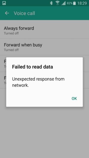

It's not just with forwarding, its as soon as I hit "more settings". I get the Network or SIM card error. I've also noticed that "call waiting" is grey? It is not black like the rest of the settings within "more settings". You can't click it at all.
Error message when I try to **004* forward from the keypad is as follows. See all pics.
This is very frustrating and we NEED a fix ASAP! Especially if people are still waiting from earlier in the year?!New Phone Error 1.jpgError 2.jpgError 3.jpg

I have the same issue. I have a Note 5 on Straight Talk (AT&T) phone and I can not access my more settings menu in my phone menu. It reads " Failed to read data; network or sim card error " I have been on the phone with tech support for youmail, straight talk samsung and at&t to no avail. What the heck is going on here? Anyone have any luck resolving this?
