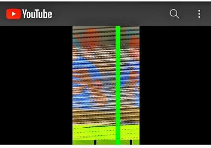

Watching a funny vid on YouTube I shared it on Facebook.
When I watch it on YT, no problem.

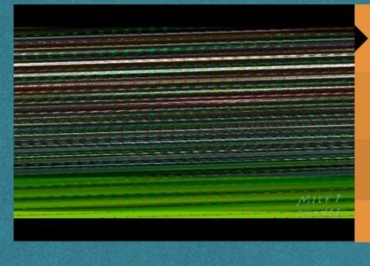

If I go to FB and click link, it starts fine, then it goes to attach. I cleared catche and date for FB an YT. Doesn't help.
I also open web page and view attached YT vid and it starts fine and then also doesn't work.
Something wrong with graphics card?
Hope not

Try uninstalling all updates to Android System Webview in the Play Store, since sometimes an update can cause glitches on certain devices.
Uninstall the update to YouTube , dont let play store automatically update it if its set to automatically update apps and test it again

When you say you turned it off, do you mean you tapped the Uninstall Updates button?
No. Don't recall you mentioning it. But I don’t see it an an app to R click on and can't find it to do.
I mentioned it in post no. 8 above.
If you tap the link for the app I shared above, does it open the Play Store to that app? If not, then go to Settings>As, tap Menu>Show System, then look for Android System Webview. Select it, and look for an Uninstall button there.
