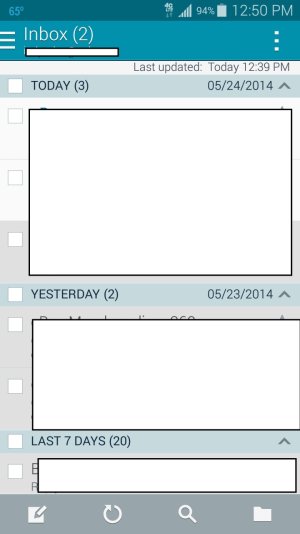

In the stock email app on my S3, there was always a button you could push to get rid of spam on your phone (or to mark an address as spam). I don't see it on the S5. Is it gone? Do you have to turn it on?
Between this and the inability to sync properly, they really screwed up the email app.

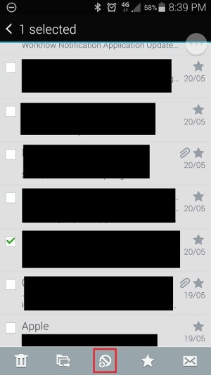

Press and hold the offending email and wait till it is selected by a tick tap the icon at the bottom which is a round symbol with a diagonal line and + symbol to add it to your registered spam list

That's the symbol that's gone. It doesn't exist on the S5.

Hi,
Taking a look at your screen shot of the light blue with no 'blocking' icon. I have the same issue. could you explain in detail how you fixed it please?
Cheers in advance.
