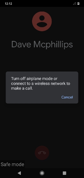

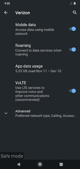

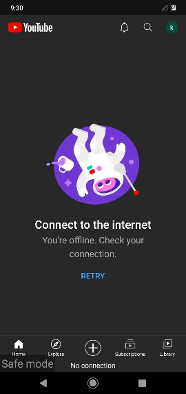

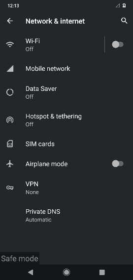

I have no access to Verizon in safe mode. It comes on with airplane mode on.
This is what I get when I do it and then turn airplane mode off.
That's odd -- you should be able to turn off Airplane Mode in Safe Mode. Is the toggle greyed out?
I did turn it off but it still won't connect to my carrier.
If you look at the second and third pic airplane mode is off.
I've never seen a phone not able to connect to the carrier in Safe Mode. What happens if you remove the SIM and reinsert it?
