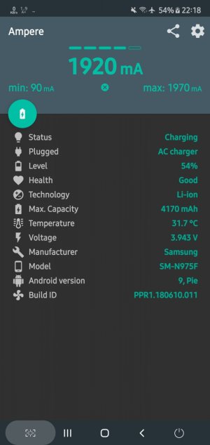

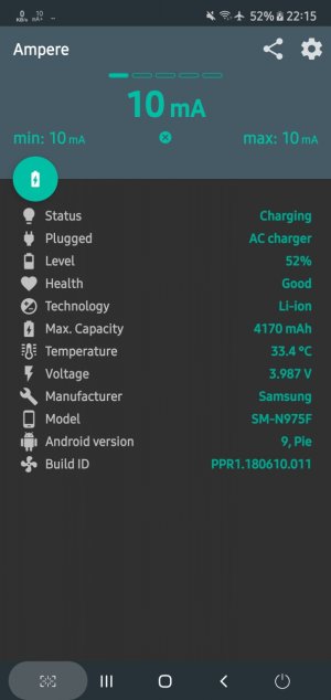

First pic is Aukey 6.6ft, second is with Apple 6.6ft and lastly third is the cable which came with my N10+. (i tested with the adaptor which came with my N10+)
With this, i conclude that Apple's 6.6ft USB-C to USB-C works best.
Im not at all shocked... Apple's USB-C to USB-C can hold up 87W...

Okay i can confirm Apple's 6.6ft USB-C to USB-C works fine...
I'm surprised by the Aukey cable I must say, even if it is a 6 ft it should perform better than that.
I liked the app enough to get the paid add free version as well so looking forward to try it on the pack of 3 different cables I have coming this week.
