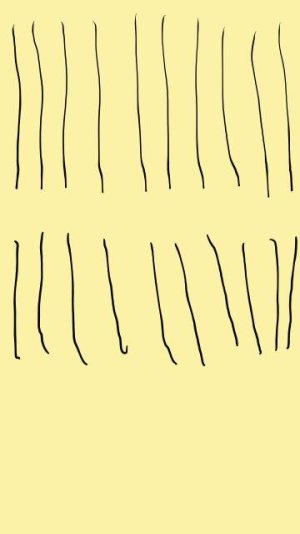

I had my Note 5 screen and digitizer replaced due to me dropping and cracking the screen. Now I have an area going across the middle of the screen where my s-pen doesn't work. I attached a screen shot. Do you think the screen is defective? TIA
Joe
