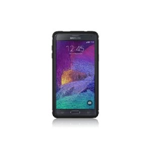

Well, I don't talk a lot on my phone..and actually just made my first call today. No one can hear me at all with the case on. I think the microphone holes are off.
Gonna try to poke some bigger home in or later tonight. Anyone else have that problem with the case?
I have the white Verizon version
I just fixed mine. took a dremel bit, a rounded cutting bit a cut a new hole in the rubber.
I put tape on the bottom of the phone. Installed the case, used a marker to stick through the case hole and mark a dot on the tape.
I then removed the case, marked a spot where the old hole was also on the tape, pulled off the tape and taped it on the case. Used the dremel, and it now works and is unnoticeable.
I tried that and ruined the case lol
I was going to take a very small drill bit and Just extend the hole 3mm left lateral
Fixed mine by just making the holes bigger on the rubber inner part. Worked great. Didn't have to touch the outer plastic portion
